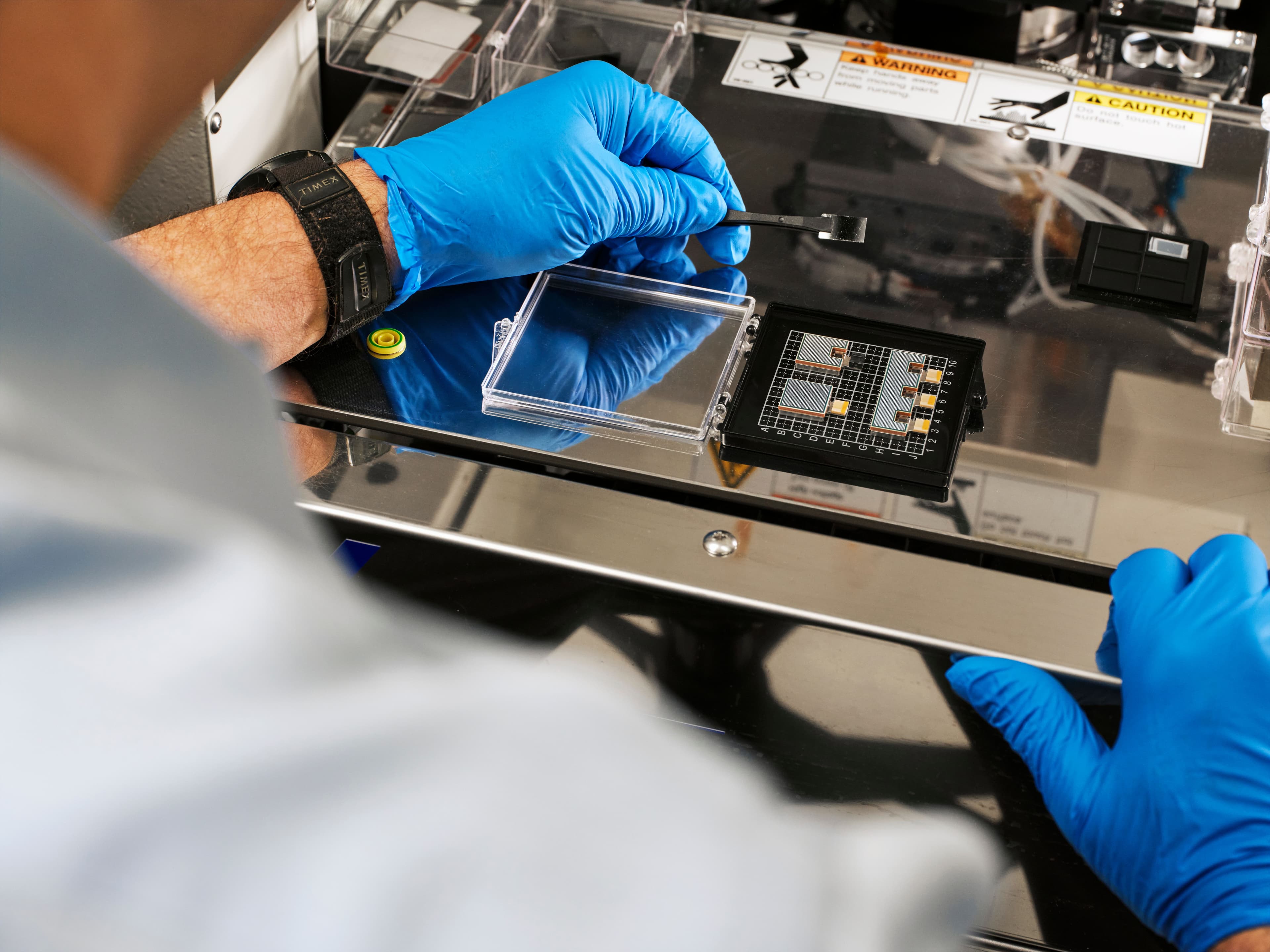

A small plastic case holds several polymer optical waveguide modules
John Knickerbocker carefully handles polymer optical waveguide modules in the lab. These connectors promise to reduce the time that GPUs sit idle as they wait for data during AI model training.

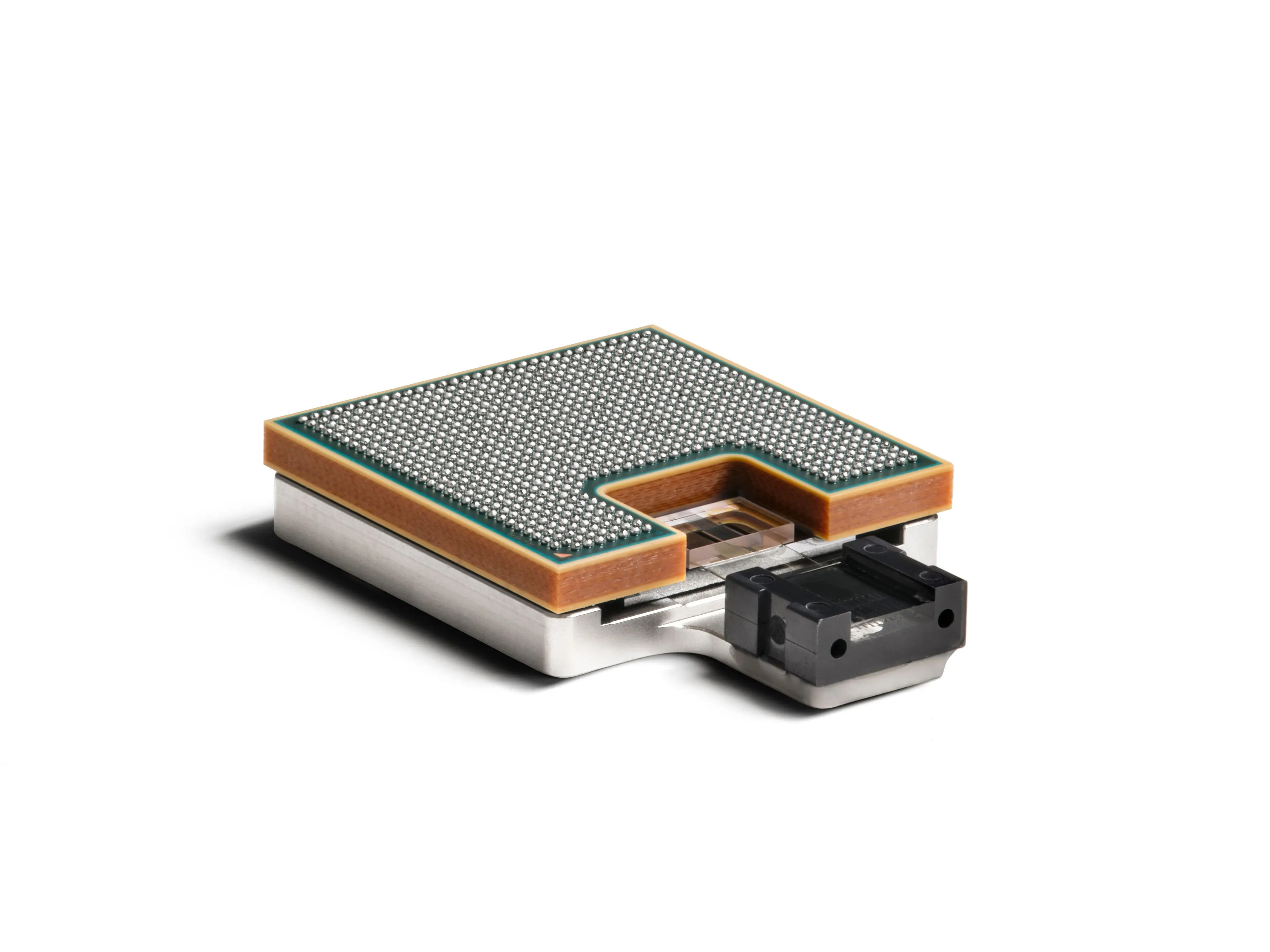

The Chiplet and Advanced Packaging team at IBM Research is seeking to streamline this system with co-packaged optics, an approach that promises to improve the efficiency and density of communication, both within and among chips. Part of bringing optical connections onto integrated circuit boards is building in transmitters and photodetectors to send and receive optical signals. Optical fibers are about 250 microns in diameter, around three times the width of a human hair. That may sound tiny, but four fibers add up to a millimeter, and as the millimeters add up you quickly run out of space at the edges of a chip.
The solution, as IBM Research scientists saw it, lies in the next generation of optical links that enable much denser connections: the polymer optical waveguide. This device makes it possible to line up high-density bundles of optical fibers right at the edge of a silicon chip so it can communicate directly out through the polymer fibers. High-fidelity optical connections require exacting tolerances of half a micron or less between a fiber and connector, a feat the team has now achieved.
Thanks to these approaches, the team has demonstrated the viability of a 50-micron pitch for optical channels, coupled to silicon photonics waveguides and connector pluggable to single mode glass fiber (SMF) arrays, using standard assembly packaging processes. This represents an 80% size reduction from the conventional 250-micron pitch, but testing indicates they can shrink this even more, down to 20 or 25 microns, which would correspond to a 1,000% to 1,200% increase in bandwidth.
